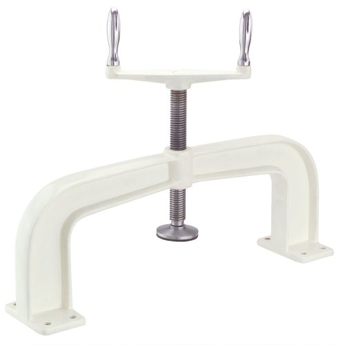

The last stack I glued up like this I clamped with about eight clamps. I finally made a big clamp like the one Frank Penta showed me in his shop. It uses a cast iron book press (from Amazon), cheaper than I thought it would be!
https://www.amazon.com/Shop-Fox-D3221-Super-Press/dp/B00012X504
