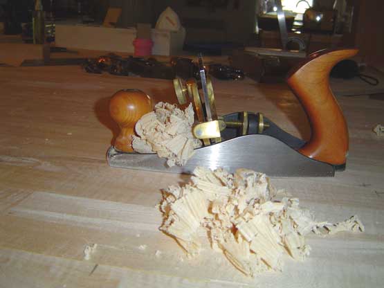

>Hi everyone,
I posted about a week ago on the comparative merits of the LN 112 vs. the LV version. Most replies were in favour of the LV, if only because of the screw to bow the blade, but I borrowed a LN from a friend and tried it out. I gave it a good sharpening and didn't roll a burr (that's how I sharpen my LV #80 cabinet scraper and it works very well). I am totally satisfied with the results. I didn't find it very difficult to set up either: I just set the angle of the bed at around 12 or 13�, layed it flat on some wood and tightened the screws; then I tilted the blade forward to around 15� and the shavings started coming out. I guess this is a gloat too because my friend sold it to me since he hardly uses it (got it at a friendly price! :)). I used D. Charlesworth's trick to hold the blade at 45� in my jig (see next photo).

Totally happy Frank
