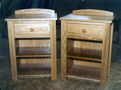

I think the problem people have with Red Oak is that many of the commercial furniture makers just put boards together as they come off the "pre-cut" part rack.  This usually results in a tiger striped or every which way cathedral layout that isn't appealing to the eye as Carlos noted above.
I've made a fair number of pieces from Red Oak and when I make parts I look at the grain patterns and try to orient them so you can't tell where one poard ends and the next begins.  This makes pieces more appealing to the eye.
Here are some of the pieces I've made from Red Oak:
ssl image hosting
