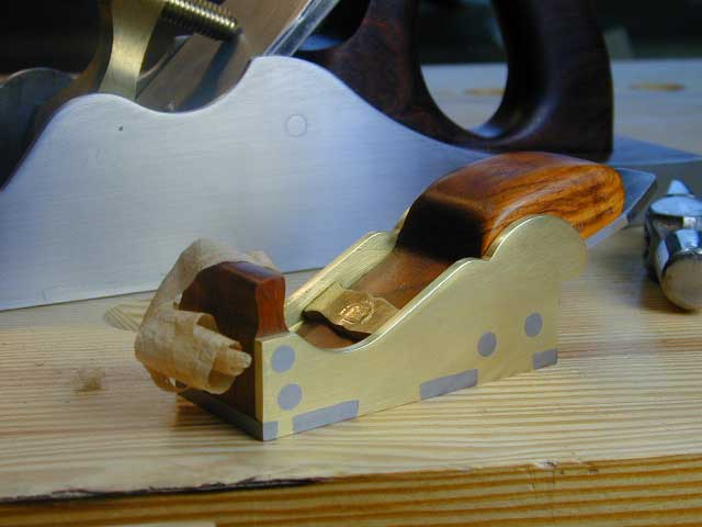

Before I discuss this plane kit in particular, I think it's important for me to note (in light of the discussion below) that I have purchased all four of these kits with my own funds and received no discounts. Shepherd Tools is not an advertiser in my publication.
The brass-sided chariot plane is probably the easiest of all the kits I've attempted (smoother, panel, shoulder and chariot). There are few dovetails. The small bed is easy to true and there are only four rivets and a wedge to peen.
The only cautions are that the brass is quite soft, which makes it easy to bend or ding during peening. And the mouth requires a small triangle file to open up. Both of these difficulties should be easy to surmount for a first-timer. The instructions are generally quite good and the boys at Shepherd are available by phone or email.

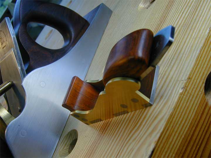

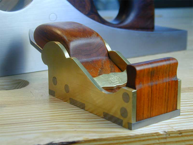

>What I like a lot about this plane are its ergonomics. Doug Evans at Shepherd told me that he started with a Norris design and then developed the shape of the components using a variety of computer and manual methods.
The front bun is the most surprising aspect of the tool. When I first saw it, I raised one eyebrow. It looked a bit odd to me. It didn't have the flowing curves of the sidewalls or wedge.
But after using the plane, I like it. The indentations front and back make it perfect for two-handed use: Thumb behind and forefinger in front. This allows you to apply tremendous pressure when you need it. And when you use the plane one-handed you can comfortably rest your forefinger on top of the front bun.
The wedge is also nice, once you modify the stock wedge a bit. The wedge as it comes has sharp coners. Knock these down with a rasp and file until the wedge feels like a worry-stone in your hand: smooth and comfortable.
What I like about the wedge and the extra-long iron is that they allow you to wrap your pinky and ring finger below them. It's a very comfortable grip.

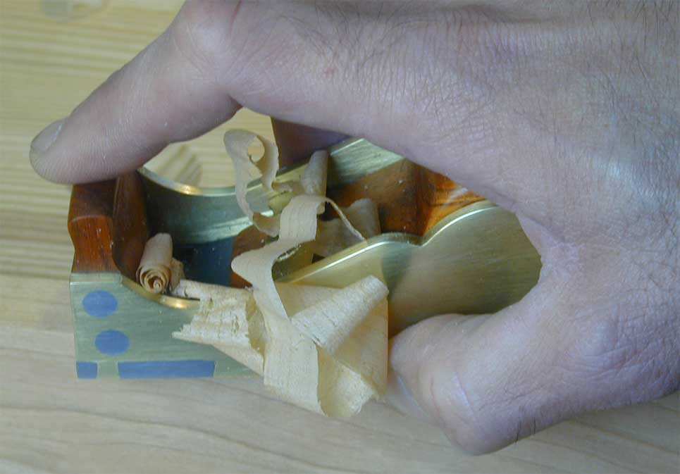

>In the photo below you can see the one-handed grip.
The plane is remarkably easy to set with a hammer. Usually it takes me only a couple taps to get the iron centered and projecting correctly. Remember to always tap the wedge after tapping the iron.

>Some details on my particular tool:
� Sole lapped to #220 grit on a DMT diamond stone. By the way, small planes are surprisingly easy to do. And good practice.
� All the wood is finished up to #400 grit. The finish is an oil/varnish blend and some paste wax.
� Sidewalls are finished up to #300 grit. Any higher and fingerprints start to show too easily.
� Total build time? I didn't keep careful track. I'd say it was about six to eight hours. I spent a lot of time getting the wedge just like I wanted it.
The Shepherd Chariot is an excellent little kit for a variety of reasons. You get a good lesson in tuning planes: filing the mouth, truing the sole, fitting a wedge and adjusting the tools ergonomics. And the result is a delight to use on edges and for smaller work.

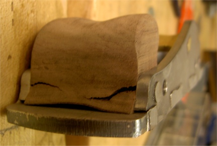

Am I the only ham-fisted moron?
Paul M. in San Diego
>Wow Chris, your plane looks great!
I keep seeing beautiful pictures of wonderfully completed Shepherd infills. I tried to make one and I messed the thing up multiple times. I got their littlest thumb plane, and I'm rather ashamed to admit made a total hack of it.
I had a few problems of things bending that shouldn't while the peining is going on, but we're talking about metal and I was able to fix most of these problems by un-bending them. But then I got to the infill process and trashed the front bun while trying to pein the pins that hold in the infill. I've attached a picture to show what I mean.
I'm generally a careful person. I've made lots of delicate and intricate things with my hands in the past. But something about putting a ball-pein hammer in my hands and smashing at metal and I just don't know when to stop. I guess that this just isn't an activity that I was cut out for.
To their credit, Shepherd tools has offered to replace any damaged parts. This would consist of only a couple of pins that I would have to drill out. But I got to the point where I just wasn't having fun anymore, so I chucked it back in it's box to let it rot.

Lyn J. Mangiameli
>Paul,
I think you have lots of company. Many metal working techiques are IME different from woodworking techniques. Precision is more of an issue, and there is also the matter of toleration for all the oil and metal particles. I think metal working just requires a different attitude.
I hate working metal. I can do it and often have to do it to remanfacture inadequate initial construction or to create custom parts or modifications, but I definitely don't think it is fun. Frankly, I did not one bit enjoy making my Shepherd smoother, except for some of the final wood shaping and finishing.
But I am also aware that many, many individuals (often with minimal metal skills and interest) have found great satisfaction in the act of producing their own plane, the opportunities it offers to create custom modifications, and/or just having the knowledge that they created their own plane. For many, it makes ownership of an infill plane achievable. I know you know this.
So while I doubt I will ever set out to make another kit, I am really quite thrilled that such things exist and enjoy seeing the results. I just know it is not any fun for me, and that I'm not very good at it either.

Christopher Schwarz
>Paul,
The hardest part is indeed the peening. My first dovetails in my smoother were decent -- nothing to write home about but nothing to be ashamed of.
After doing it once, however, every other plane has been a snap. Part of the difference is likely a bit of experience. But I also now use punches to drift the steel into any gaps that persist. And I picked up a couple peening tricks from Wayne Anderson (see the link below from Russ Allen's excellent site).
Filing a gullet in the protruding joints as Wayne does adds about 15 minutes to your build time but it also greatly reduces glancing bows. And that's what I suspect was part of your difficulty.
And Wayne's method of attending to gaps works well, too.

Ben Knebel
>Hi Paul;
I hate to see this happen to anyone--building the plane should be a joy not a frustration.
Our offer still stands---we'll send you a whole new kit --gratis--if you want to try again.
Alternatively--if you are willing to wait awhile---I'll build you one and send it along.
>Thanks Ben for your gracious offer. I am indeed aware of how you stand behind your products and I went out of my way not to blame you or the product for my failure. That sits upon my shoulders alone.
I didn't particularly want the thumb plane in the first place, I just wanted the kit to try something new to see if I liked it. The price was too low to pass by, as I just couldn't get myself to put down enough $ for a smoother kit. This was a rather cheap lesson to learn that I just don't like working with metal. I just wanted to find out if there were any others like myself on this board, and I found that Lyn is of like mind (but with better 1st pass success).
So I'll decline your offer for the repairs or for a completed replacement. I hesitated posting this my picture in the first place, as I thought this would be your response. I'll also fade away on this subject as I don't want to be a recurring pain in your side.
I'm still interested in having a good smoother someday, but I'll be buying one that's already been made by someone who knows what they're doing (not by me!). Your company is still in the short list of vendors that I'll be using for this purchase. I'm hoping you produce a 50-degree angle adjusterless smoother before I pull the trigger.
