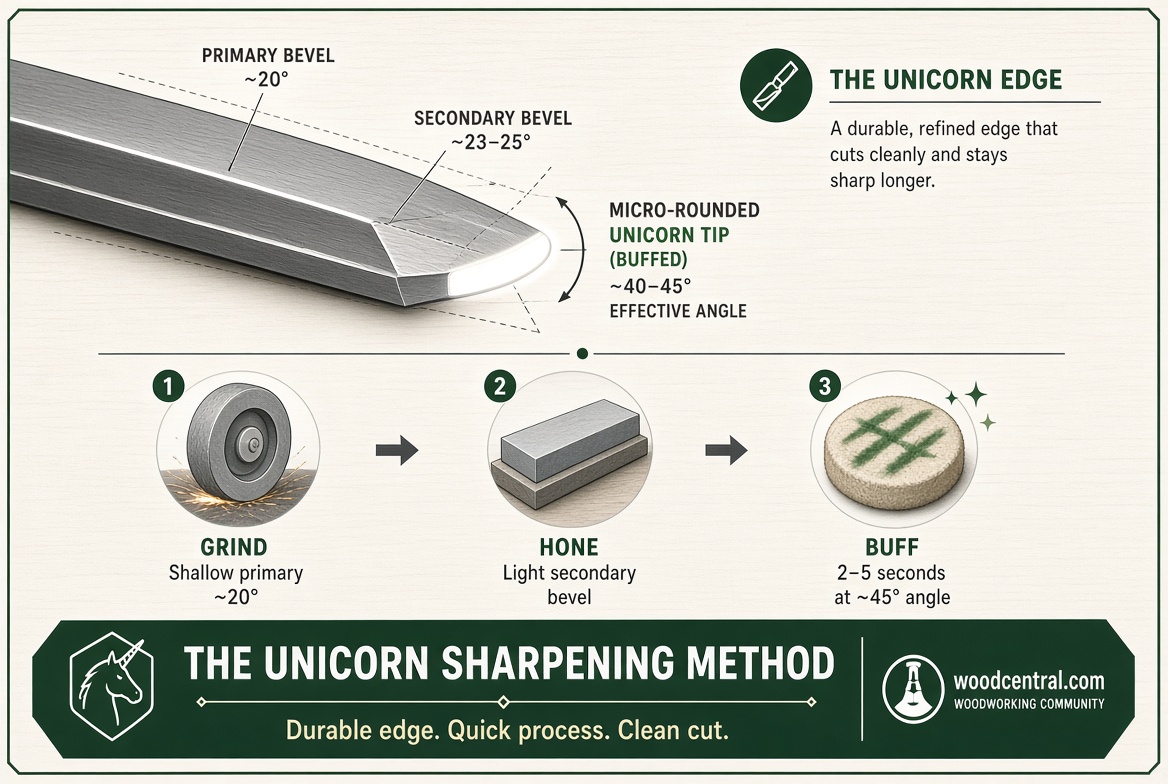

  1. this should be removed. The original article is fine, and the picture has information in it that is both false and visually misleading where it’s not.
    Reply
    • Thanks. Graphic removed.
      The graphic was AI generated based on your article. This is out of my wheelhouse, and it looked reasonable to me so I added it. (Adding a “hero graphic” to articles increases the odds of people actually reading them, so I try to come up with something to pique interest.)
      Reply
      • Text looks good enough as a lead in to read the whole article! At some point, AI will be more precise with this stuff, but it can do some whoppers right now both in some very black and white interpretations of things going the wrong way, and in converting language to image.
        Reply
