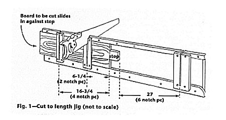

  1. Cut pieces to length (Figure 1)

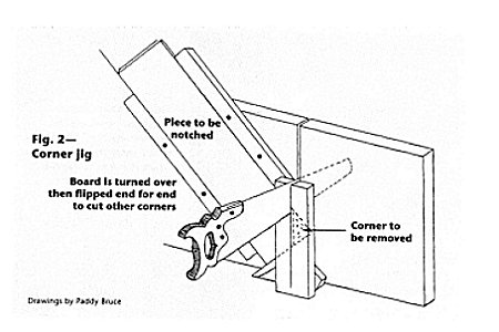

  2. Cutting the corners (Figure 2)

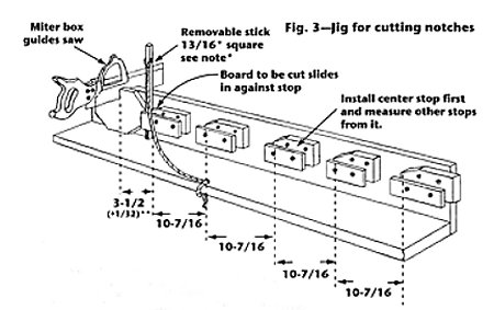

  5. Cutting the notches down (Figure 3)
  6. Forming notches by removing plywood between saw cuts

I cut the plywood sheets into strips so the students started with a pile of strips 5½” wide and 48″ long. These strips had to be cut into the correct number of pieces of the proper length. The long strips were inserted into the jig in Figure 1 and cut at the proper slots. Students repeated this operation until we had 43 two-notch pieces, 27 four-notch pieces and 10 six-notch pieces. The long roof boards and the 10-notch pieces were already cut to length.
The jig worked well. The students’ tendency was to hurry and be swept up by the cutting, so I monitored to make sure they cut the proper number of pieces. Working in pairs helped. One worked sawing while the other set up the next piece. Some workers were so diligent they got blisters. I encouraged them to slow down and pace themselves. With 100 5½”; cuts, pacing is important!
Cutting the corners was straightforward. It was hard to make a mistake with the jig I constructed (Figure 2), but it was hard work. We made 100 notched pieces, and each piece had four corners to cut. Often after ten minutes of cutting (two or three boards), students needed a rest.

The width, depth, and spacing of the notches is critical. If the notches are too wide or deep, the house will be wobbly. If the notches are too tight, children using the house will become quickly frustrated. If the spacing between the notches isn’t exactly the same, the boards will not line up when building a house.
To keep all these cuts in the right place I made a jig using a metal miter box to hold a back saw in exactly the right place (Figure 3). I used carefully measured stops to gauge the distance between notches and a stick that was 1⁄16″ thicker than the notch width to gauge the notch width. Although there are several steps to using this jig the students caught on quickly and the notches came out in the right place.
  • * This stick was designed for ¾” plywood that measures 23⁄32″ thick. The removable stick dimension should be changed if your plywood is a different thickness.
  • ** If you add 1⁄32″ here, measurements can be kept in ⁄16″ . Otherwise it gets confusing, not to mention difficult, to measure. Or just forget the 1⁄32″. This will make the 1⁄16″ closer to one end. No one will notice and it makes the measuring easier.

Because notch width, depth, and spacing is so critical, it is necessary to check each and every notch. I stationed the jig for cutting notches next to the vise for removing the plywood between the saw cuts so the people doing theses jobs could communicate with each other. If there was a problem, it could be corrected before many pieces were cut. I made it the responsibility of the person removing the plywood from the notch to ensure that each notch was the proper width and depth and had the proper spacing.
