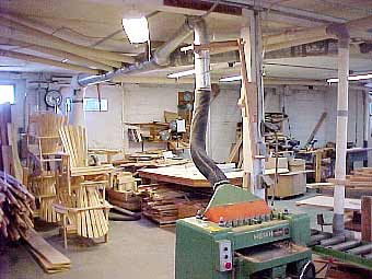

Interior of shop. Note handle for reching blast gate on planer.

So I first began my system design for 10-20 machines, I have 16 at present and am taxing the suction to about the limit. Nothing settles in the pipes but I could use a little more suction at the thickness planer which needs the most velocity. All the sanders and saws are serviced just fine by the system.
Wooden blast gate with long handle. Steel pipe meets pvc.

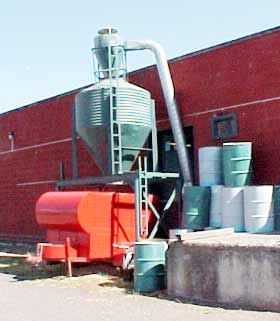

The blower (fig. a) is 34" diameter by 9" wide with a 1.5" shaft. I found this blower in an agricultural junkyard for 125 bucks, it is off of a Chisholm-Ryder pea combine. I had it modified with a longer shaft and inlet sized for my needs. The inlet is 12 and by way of the Grainger catalogue I was able to determine velocities and horsepower requirements by using similar sized blower data. I run ten HP via belt drive (two "b" belts) and run the unit at a conservative 1500 rpm for durability. It has been running daily now for eight years without interruption.
The cyclone is off of a hay chopper. Every hay chopper has one. I paid $50 for it. Inside I bent an 1/8" steel plate into the mouth of the inlet for wear resistance as sawdust under pressure is highly abrasive. The bin under the cyclone is a seed or feed bin like you see everywhere farmers are. The stand was made by a local steel fab shop The dust pipe is all steel spiral pipe except for the drop to the machinery. The cyclone separates all but very fine sanderdust, nothing is visible but slight dust emissions when stroke sanding.

Top of cyclone is 22ft.
I make enough dust now I had a trailer with an opening in the top made just for sawdust. It also doubles as a tool shed on out of town jobs. The bin holds 1 unit or 1-2 weeks worth of chips and the trailer holds exactly one bin full giving me nearly a month not to worry about sawdust. This amount is also equal to a pickup truck with sidetracks full. Emptying the bin is where this particular unit has trouble. The cone shape packs in and in winter freezes up at the bottom making a quick 5 minute dump into 20 minutes of frozen sawdust battle from the small amount of water that creeps into the bin. This system could well cost upwards of $10-15grand or more engineered and installed but some dirt under my nails, some bathroom reading (ya know technical stuff) and a total investment including pipe, I farmer'd it together for $5k incl. trailer.. Times a wastin, got me a stack of boards to plow before it rains.
