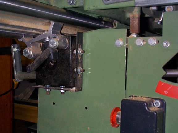

The included instructions for the above kit are not entirely helpful, hopefully this file will help you through the installation. Please refer to the following photo:
{short description of image}

The micro-adjust kit sold for the X31 consists of a pair of black brackets and "floating" blocks.  The brackets are attached to the X31 side panels and the blocks adjust the sliding rail system in all directions.
Your first challenge will be to simply visualize the concept of how this system was intended to work.  It is not a common U.S. design, but I have seen it on a few other European machines (my Italian bandsaw for instance).  The system relies on a set screw and two nuts, with one nut on either side of a bracket.

In my opinion and in my use, the way the adjustment feature works is that the four allen bolts that have the nuts on either side of the bracket are supposed to pull the solid block one way or another when turned - they are not supposed to move (substantially) themselves in relation to the bracket housing. This is achieved by the proper nut not allowing the allen bolt to move "through" the bracket housing - the nut will however allow the allen bolt to turn, thus screwing into or out of the solid block, meaning the solid block will move since the allen bolt is more or less "stationary".
Think of it this way - once a nut is tightened against the bracket housing, the nut and the allen bolt become an "assembly", in that the nut is a "stopper" that turns with the allen bolt and won't allow the allen bolt to move through the bracket - but the whole "assembly" turns and thus makes the solid block move. Or, an analogy - think of tightening a bolt on the top side of some stationary bracket that has something beneath it. The bolt head sits on the bracket (via gravity) and rotates, and whatever is below it moves "up" to meet the bracket. The same principle applies with the micro-adjust kit.
Start by screwing all eight allen bolts into the solid block a decent amount, maybe 1/3" or so. You only need to set up the assembly (meaning with all eight allen bolts in 1/3" and making original, gross adjustments via the rail holding brackets and their two bolts) within about 1/4" to 1/3" or so of the "final" destination - the allen bolts can adjust it the rest of the way. To move the solid block up, make sure the top nut is tight against the bracket housing, the bottom nut is "loose", and screw the allen bolt "out". This will cause the allen bolt and top nut to turn together - not moving the allen bolt through the bracket housing, but causing the block to move up as the allen bolt "screws out of" the solid block. The reverse, using the bottom nut, will cause the block to move down. Remember, when you're "using" the top nut, make sure the bottom nut is loose, and vice versa. With the two allen bolts on each side of the solid block, you can adjust the angle as well as the up and down.
Once you have it all adjusted, snug the two nuts down on each allen bolt to prevent further movement. The large bolt that goes through the holes you drill in the sheet metal, along with the chamfer-headed screws that go into the housing and sit flush against the bracket face would appear to "lock" the solid block in place once you've made the adjustments with the allen bolts.
