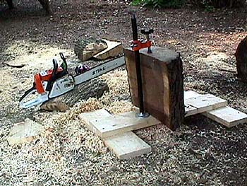

Here's a surprise one. I had in in the camera, so you all get it for free (actually they're all free). This is a bowl blank sawing jig I made after reading about a similar, but more complicated design somewhere on a BB. I built this thing because it is realtively easy to saw log sections in half, but slicing them down for bowl blanks can be slippery and frustrating. This is version 1.0, with improvements already in the works. The improvements will undoubtably wait until I either saw through this thing or the post comes out, which it is in the process of doing right now. The screws are pulling out of the soft pine. When I rebuild it, the post will be attached by through bolts and nuts. I will also fasten a strip underneath the support for the blank so that the support becomes sacrificial without compromising the integrity of the jig.
It is pretty easy to build and use. I bought a Pony clamp that slides along the pipe but also has a screw adjustment on it, a 24" length of 3/4" black pipe, a pipe flange,and an 8' 2x10. Assembly should be apparent, dimensions are not critical. To use it, place the blank on the jig, and clamp it down. It works quite well, and I have had a significant improvement in sawing out uniform bowl blanks.
