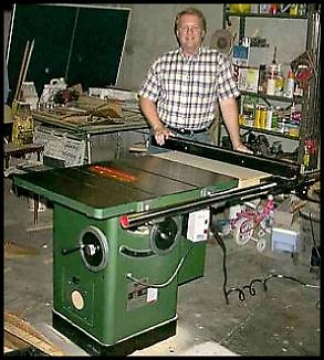

[Satisfied customer]Finally... here's what a satisfied customer looks like. This picture also illustrates one more change I'm going to make to the saw. You'll notice that the magnetic switch is mounted on the right side of the cabinet. That means I have to lean over to turn off the saw, often with a cut off piece of wood still sitting on the table next to the spinning blade. I don't like ever getting in the path of that blade when there is a cut-off on the table, so I now shut the saw off with my foot. As soon as I find the time, I'm going to mount the switch on the bottom of my fence rail on the left side of the blade where it should be!
