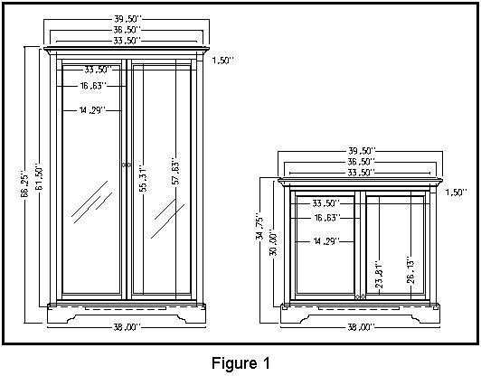

The biggest advantage to CAD software is its ability to let the draftsman edit a design. Once a drawing is completed, it is fairly easy to adjust the height, width, etc. or try different detail treatments on a basic object. When you change the proportions in a CAD drawing, the dimensions are changed automatically to the new size. So a case that is 66 inches tall can be 'shrunk' to 34 inches in a matter of seconds to create a companion piece (see Figure 1).
