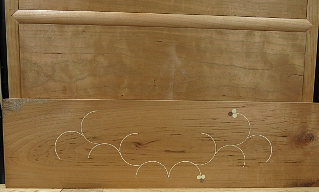

Before scratching on an actual drawer front I needed to see what this paper pattern would look like in reality. Also I wanted to determine if it would look good on cherry. I have never seen Line-and-Berry done on cherry. And finally, I needed to determine what size berry looked right.
Shown in this final photo is the test pattern hastily I scratched on a cherry test piece. The first thing I learned was that I was out of practice scratching--ragged cuts, points that slipped out, etc.--but, a test pattern emerged and I find it OK for the need. Oh, I never explained the need. I promised granddaughters I would have something special on their dressers.
