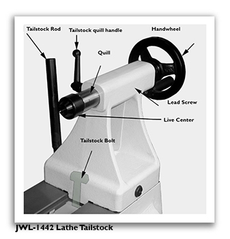

- Does the quill on the tailstock travel smooth or are there any hangups?The lead screw of the tailstock quill could be gummed up or, worse yet, worn out from poor upkeep.
- Is the Live Center missing or damaged?

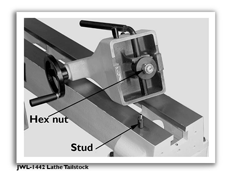

- Does the tailstock anchor down tightly?Be aware of the threads on the tailstock bolt. They may be damaged or, more than likely, the hex nut on the tailstock bolt just needs to be tightened. Simply remove the stud, loosen the tailstock handle and slide out the tailstock.
- When loosened, does the tailstock slide smoothly? If not, it could possibly be a simple fix. Try removing the tailstock and cleaning up the underside.
