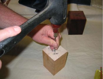

The first step in preparing a blank for mounting between centers is to locate the center on each end. Here a center finding jig is being used to mark the center. It is best to mark from all four corners to ensure finding the true center.
With an awl make a shallow mark on each end to locate the exact center. The points of the drive center and live center will be located by these marks.

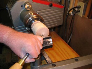

Mount the lid section in the chuck and face off the blank removing as little wood as possible. The more wood that is removed from the outside edge the more apparent the misalignment of the grain will be. From the outside edge try to angle the cut in slightly rather than making the face of the lid completely flat. This slight angle makes it easier for the lid and body to align and helps to disguise the join between the two.

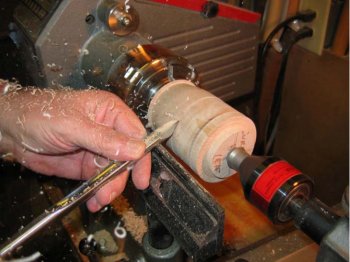

Using a sharp spindle gouge begin hollowing the lid. Cut from the center out and leave plenty of wood near the edge for the lid flange. The flute of the fingernail ground spindle gouge is aimed in the area between 9 and 10 on a clock face.
With a freshly sharpened and honed square scraper cut the lid flange. Push the tool in as straight as possible and make the cut in steps to avoid a catch or chatter. The object here is to end up with lid flange surfaces parallel.

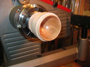

Once the flange is parallel use a freshly sharpened spindle gouge or as pictured here a sharp round nose scraper to clean up and detail the inside of the lid. Be careful not to damage the lid flange.

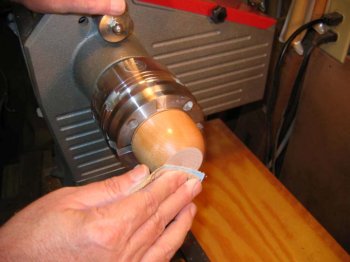

Sand the inside surfaces of the lid. Be careful not to sand the inside edges of the lid flange as sanding them can result in the flange becoming out of round. A quick swipe with a fine grit paper is all that is needed to smooth the lid flange if the surfaces were cut cleanly.

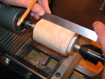

Once the sanding is complete use a couple of rules to measure the depth of the lid. This measurement will help establish where the parting cut and top of the outside of the lid will be.
Here the measurement from the inside of the lid and an approximation of the lid thickness is marked on the lid exterior. Typically allow 316-¼" thickness for the lid thickness when parting off. Design of the lid will be the determining factor.

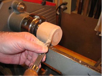

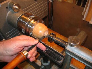

Chuck up the body of the box. Measure the approximate length of the box flange. The toe of the skew is used to sever the fibers and approximate the length of the box flange where the lid will over fit the box. This helps to minimize grain tear out during the next step.
Use a parting tool to cut a tapered lip on the box flange. The object here is to cut a tapered shoulder where the lid will just begin to go onto the box flange. Do not cut the box flange so that the lid will fit at this time.
A skew can be used to do a peeling/scraping cut for better control and less splintering of the box flange as it nears the diameter where the lid will just begin to go on. Test the lid on the box flange frequently and when it just fits on the tapered flange at all, stop cutting.

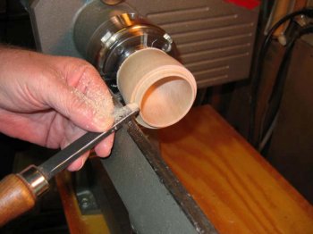

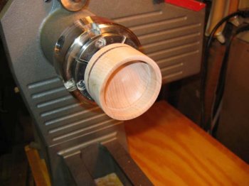

Use a freshly sharpened fingernail profile spindle gouge to hollow the box body. Remember to allow enough thickness in the area of the box flange so that it can be adjusted later on to fit the lid.
A curved scraper is being used to refine and smooth the inside shape of the box after the spindle gouge work. Sharp scrapers work very well on end grain if a light touch is used. Little wood is being removed here, just smoothed out.

Sand the interior using a complete range of grits through 400 or higher depending on the wood. The finish on the inside should be as good as that on the outside.

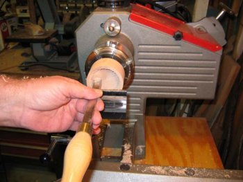

Once the sanding is complete use a sharp skew to fine tune the box flange. After hollowing and sanding the flange might be out of round. At this point the flange should be cut as cleanly as possible. The lid should be able to be jam fitted onto the box flange securely enough for turning but not so tightly as to split.

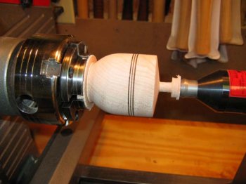

With a sharp detail gouge the exterior of the box is turned to shape. Note that a live center has been brought up for support.
Nibble away the excess material on the lid so that the top can be accessed with a gouge while still supported with the live center. Use the live center to provide additional support for as long as possible.
With a fingernail ground spindle gouge, begin shaping the top of the lid. This operation is much easier with the live center providing support. A catch in the end grain can tear the lid from the box and damage it.

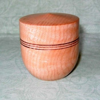

Here is the finished box; 2½" in diameter and 2 58" tall…
…and below is an open view of the box.
