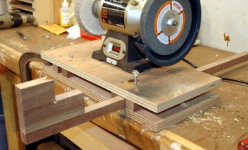

Here is the base with the grinder on it.

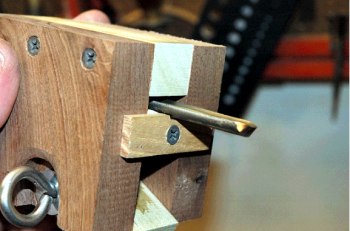

Here's a shot of the jig that holds the gouge. The thumb screw near my palm pushes up a cradle that holds the gouge in tight.

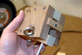

This is the front.

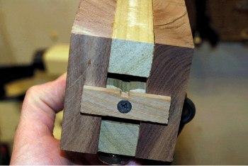

Here's another. The screw eye tightens to adjust the angle. The plans I saw (and web sites) showed making several different blocks with different angled rods and/or they showed bending the rod. I think making it adjustable works fine.

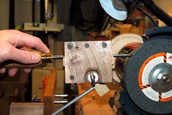

This is what it looks like in use.
