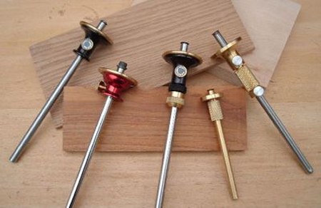

From left to right:
Veritas standard, Axminster, Veritas micro-adjust, Lee Valley 3 in 1, Tite-Mark.
(Click on name to go directly to its review)
Of course they're all capable of marking a line, but there were a couple of features I looked out for especially; whether the cutting wheel screw was flush to allow marking into confined spaces/direct transfer of dimensions, if the fence face was countersunk to allow the cutter to be fully retracted for storage, if the gauge rolled off the bench, and the ability of the cutter to be mounted bevel out for gauging in thickness planing and other similar tasks. That last criteria has an awful lot to do with the Charlesworthian influence on British amateur woodworkers; whether it's really necessary to you is, of course, up to the individual.

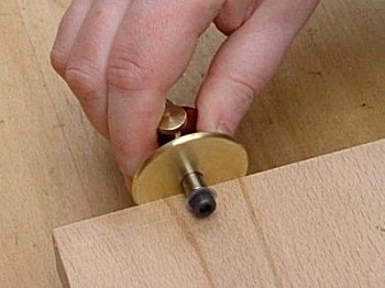

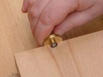

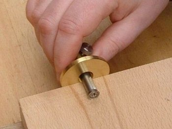

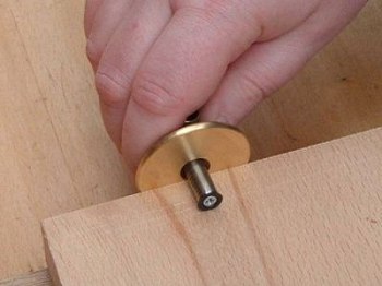

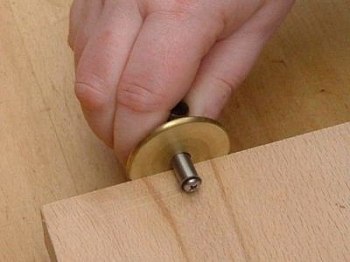

Wheel gauges are ideal on a narrow edge; it's simply a matter of rolling the wrist.

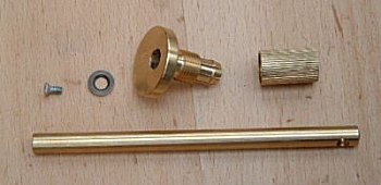

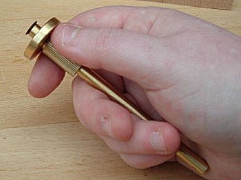

Lee Valley 3 in 1 Marking Gauge   ≈$16.50 USD
The smallest of the bunch, this Canadian gauge is a mere 115mm long with a 25mm diameter fence. The stem is off-set in its face, which gives a double benefit of more bearing surface and stops the gauge rolling off the bench. Despite its size, being solid brass, it packs a compact punch at 66g.

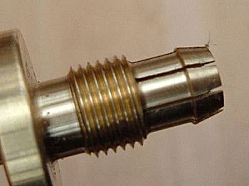

The fence is tightened using a collet system; this requires two hands, so I've found setting the gauge is a case of getting close, partially tightening the collet, checking the setting and adjusting as necessary, tightening the collet fully and then checking again.
Takes longer to write than do, but the collet style of clamping does mean the fence tends to rotate (and inevitably advance) if you're not careful. It does make for a neat, slim line feel to the fence for your fingers though.

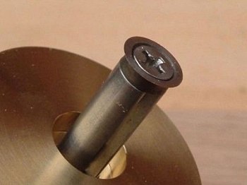

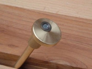

The cutting wheel is held with a small crosshead screw, which is countersunk, but the fence face is not recessed.
The cutter can be reversed and still held securely, but of course the screw does then protrude a little. In addition to the wheel, this gauge has a bonus in that it comes with cutting blades and pins, stored in a sturdy tube, giving you a whole gamut of marking options. An additional stem is also available should you want one permanently set up with the wheel, and one with the cutter or pin.
I like this gauge. It's by no means perfect; the fence locking needing two hands is a bind, its capabilities are limited by its very smallness, and it's only available direct from Lee Valley. But it feels right. Time and again my standard gauges have felt clumsy and oversized for various jobs, but this one is just ideal. The other marking options are simply a bonus. Great little gauge.

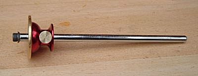

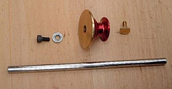

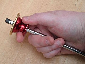

Axminster's Taiwanese offering certainly wins the cheerful appearance prize with its shiny 180mm long stem, bright red aluminium fence body and 3mm thick brass face.
The body of the fence has an unusual, stubby shape, which looks good but doesn't make for such comfortable resting places for fingers and thumb.
The fence is held with a traditional screw, knurled brass, bearing on the stem, and the fairly chunky cutter is held with a hex head cap screw that sticks out a full 5mm. The fence screw sticks out quite a bit too, which acts as a weight to stop the rolling off the bench. The whole thing weighs in at 135g. This gauge has a scale on the stem in both 116" to 6" and millimetres up to 150mm, which shows willing, but it's rather inaccurate—starting as it does 1mm out right at the 10mm mark. Unusually the cutter is provided already mounted bevel out, and very blunt; the 44mm diameter fence face is not recessed for it.
The cutter works fine put the right way, but the scale is them 1mm out the other way… Setting it, ignoring the scale, is very easy and a one-handed job. Like the Veritas below it utilises an O ring to hold the fence snug on the stem. Occasionally I've found you get a tiny amount of spring-back from the O ring between pulling it back and tightening the locking screw. It's easy to compensate for, in fact I didn't realise I was compensating for it until doing this review, but something to aware of if you like to set your gauges to very small tolerances.
This gauge has potential; it really needs some time devoted to the cutter to sharpen it properly. I feel it's been made by people who haven't really understood what it's for; the bevel out cutter is a pretty clear indicator of that. Unless it's an attempt to corner the bevel out wheel gauge market… It's nearly got the idea, but not just not quite right. The scale is just hopelessly misleading. One to consider if every pound is an issue in your tool budget, but be prepared to put some work into that cutter.

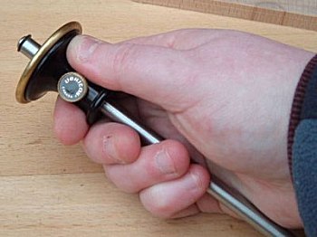

Veritas Standard Wheel Gauge   ≈ $24.50 USD

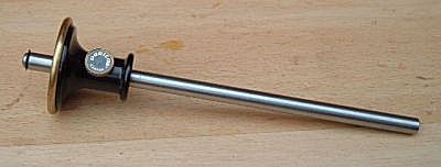

I was going to include this one, despite the changes made since I bought this old design, then I thought maybe I shouldn't, and then I decided I might as well! This is Veritas' basic, no adjuster, no scale, gauge. 180mm long stem in a black aluminium body with a 44mm diameter, 3mm thick brass face.
My old one comes with a roundhead crosshead cutter screw and no recess - it's typical of LV that, despite the success of the gauge in this early form, they've upgraded it to a countersunk screw and now provide a recess. The recess is a big help to protect the cutter, 'cos this thing rolls! Mine weighs in at 128g.

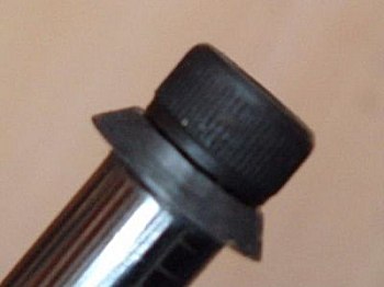

The cutter can be reversed and still held securely, although the screw on the new type will no longer be flush of course. Just like the Axminster (or should that be the other way round…?) the fence is held snug with an O ring and locked off with a knurled brass screw bearing on the stem. Again, a one handed task, and again a fractional tendency to spring-back occasionally, in my experience at least.
This is a basic, no frills, bomb-proof gauge. The “original” model of the modern era, and a reliable tool; simple and comfortable. My only real beef with it is its lemming-like habit of rolling off the bench, and that's nothing I can't live with if only I was more organised…

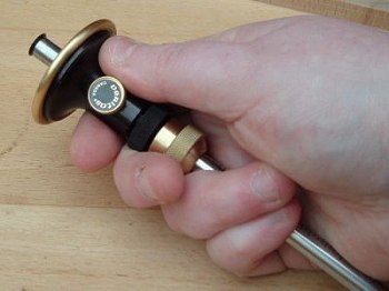

Veritas Micro Adjustable Wheel Gauge with graduated scale.   ≈ $34.50 USD

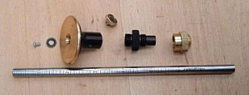

I'll have that on rye with mayo too… Yep, all the bells and whistles on this one. This gauge has a 200mm long stem in the familiar 44mm diameter fence with 3mm brass face.
The body of the fence is considerably longer to accommodate the collet type locking and the knurled brass screw bearing on the graduated stem.
The scale is in 116" up to 6" only, no metric, but seems to be bang on the money for accuracy. With the trifle unwieldy extra stem length and fence gadgetry this gauge weighs in at 156g.

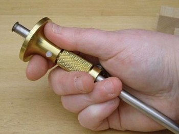

Adjusting it involves two hands, and two types of locking mechanism. Firstly you have to lock off the tail of the fence using a brass collet type, then micro adjust by rotating the brass knurled nut while holding the fence. This results in the whole stem rotating through the fence, rather than the fence itself advancing or retreating. Rather disconcertingly that means the scale is only visible part of the time as it revolves in and out of sight. One revolution is equal to 1/32” or not much in millimeters…To lock that off you tighten the rather more familiar brass screw.
There's also an O ring to stop the fence sliding too easily. The cutter screw is countersunk, unless you want to reverse the blade when it sticks out just a little, and the fence face is recessed.
Although this gauge does roll around on the bench, the long stem and weight of the fence combine to prevent it doing too much before inertia stops it.
This gauge has all the features of the basic model, which I like. The real question you have to ask is whether the micro adjust is really worth the extra. It does work, no question of that, but it's not exactly intuitive and feels like rather an inelegant solution to the micro adjusting problem to me. I'm sure you'd get used to it over time, but I didn't think a marking gauge needed to be micro adjustable when I started this review, and the Veritas hasn't really done anything to convince me it's a desirable feature.

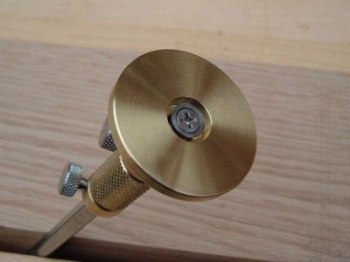

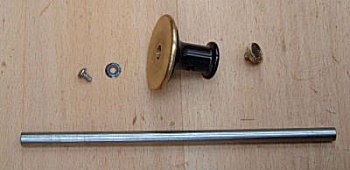

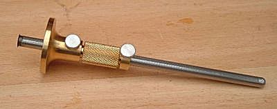

Glen-Drake Tite-Mark Marking Gauge   ≈ $78.99 USD

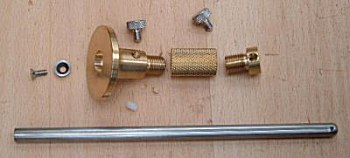

Endorsed by Lie-Nielsen, this is the closest you'll get to an L-N marking gauge not actually made in Maine. Weighing in at a hefty 189g, this gauge has a 180mm long, steel stem and a solid brass fence, 41mm in diameter with a 4mm thick face.

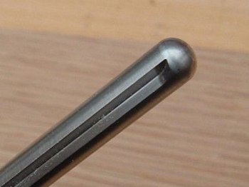

Knurled steel screws lock both parts of the fence, bearing in a V-groove milled down the length of the stem, which prevents the fence rotating.
The screws are sufficiently long to prevent the gauge rolling. Adjustment is a simple matter of locking off the tail of the fence, rotating the knurled brass ring to micro adjust, and then locking off the main fence screw. It can all be done with one hand, and a small nylon screw can be adjusted to tweak the amount of resistance between the head and stem. Bizarrely I can't find any figures for just how far the fence is moved with one revolution, but it seems to be around 2mm.
The cross-head cutter screw is well countersunk, and the face of the fence is deeply counter bored to protect the cutting edge.
The latter is razor sharp. Unlike the other gauges' cutters which are fairly thin and flat, this one is shaped a bit like a straw boater (hat), the cutting edge being the brim.
That means reversing the blade negates the ability to take direct dimension transfers, but it's not really an option anyway as the screw doesn't hold the cutter particularly well when reversed. As a result of requests I believe a bevel out cutter is now available as an extra. A scoring blade and mortise blades are also available as extras, although Axminster doesn't currently stock them as far as Im aware.
The L-N of wheel gauges? Undoubtedly. This is a very classy tool, made with the best materials and beautifully engineered. If you like to have the very best then this is a “no brainer”. Adjustments are very smooth and easy to get to grips with. I was adjusting it like I'd had it for years within minutes. For a while there I was cheekily wondering what Axminster's policy on reviewers buying review tools was, until I came to my senses. Great gauge, beautifully made—ghastly price.

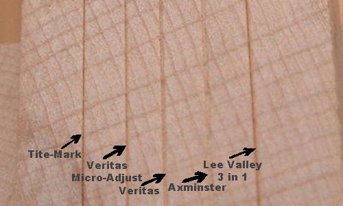

Gauged lines
So to the crux of the matter, the one thing everyone wonders. Is the Tite-Mark worth the extra money over the Veritas micro adjust? It's very, very easy to get carried away with this gauge and convince yourself you need it. The truth is it doesn't actually gauge a straighter line than any of the others. After careful study I could argue the line is fractionally sharper than the others, but that advantage lasts only as long as the edge. The micro adjust isn't really any more necessary—to me, at any rate—just because it's easier to do. If you want one, then go ahead and enjoy. It's a fine tool.
Do you need one? Well personally I don't think so. If you absolutely must have the ability to micro adjust your gauge then the Tite-Mark is unquestionably the nicer of the two, but the Veritas works just fine (just forget the graduated scale I reckon). It's just slightly more of a fiddle to do.
