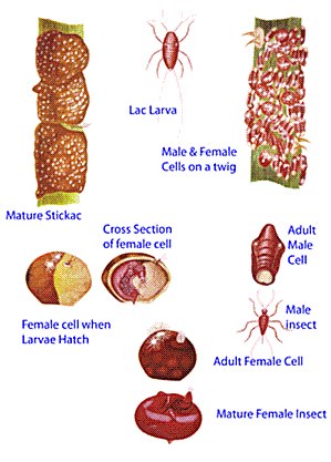

Shellac has the distinction of being the only known commercial resin of animal origin. It is produced by a tiny red insect (Laccifer lacca) which, in its larval stage, is about the size of an apple seed. Swarms of the insects feed on certain host trees, commonly called lac trees, in India and Thailand, the main lac-producing countries.
Their whole life cycle spans six months and is devoted to eating, propagating, and creating lac as a protective cocoon for their larvae.
During certain seasons of the year, these tiny red insects swarm in such great numbers that the trees at times take on a red or pinkish color. When settled on the twigs and branches, they project a stinger-like proboscis to penetrate the bark.
Sucking the sap, they begin absorbing it until they die. In shellac lore this is the feast of death. While they eat they propagate, with each female producing about one thousand eggs before dying.
In the body of the lac insect the digested tree sap undergoes a chemical transformation and is eventually secreted through pores. On contact with the air, it forms a hard shell-like covering over the entire swarm. In time this covering becomes a composite crust for the twig and insects. Only about five percent of the insects amassed on the trees are males. The female is the main shellac producer.
While she is secreting lac, she is preparing herself to die after providing a fluid in which her eggs will mature and from which the future supply of bugs will come, to repeat the process of swarming, propagating and creating the next season's shellac harvest.
The males, having fertilized the hordes of females, also begin their life-ending feast. Although they contribute relatively little more to the shellac crop, they have already assured an ample supply because the females vastly increase their output of lac after being fertilized. The great mass of male and female bugs on each tree gradually becomes inactive as the shell-like covering forms over them. In the sixth or seventh months, the young begin to break through the crust and swarm to new feeding grounds.
Shellac cultivation yields a large crop by helping the larvae find better locations for their feast. This involves simply cutting lac-bearing twigs from an infested tree a few days before the emergence of the larvae. A bundle of such twigs, known as broodlac, is tied to an un-infested tree on which there are many tender new shoots. This results in a higher survival rate of insects and a greater yield of lac since only a little broodlac gives forth sufficient larvae to infest a tree thoroughly. No further attention is needed until shellac is harvested.

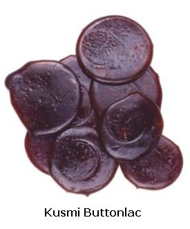

If there is a demand for it, the bhilwaya will opt instead to make button lac. Instead of stretching the molten lac into sheets, the bhilwaya takes the lac from the twisting bag with a spatula and spreads it out in the form of a circular disk or button about one to three inches in diameter. Before it hardens completely the button is stamped with the seal of the manufacturer.
Button lac

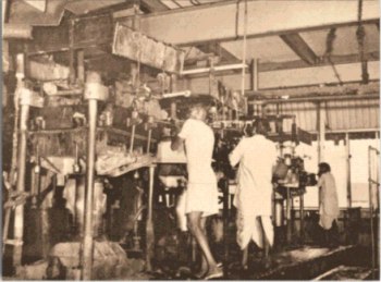

Shellac manufactured by modern mechanical methods is called machine-made shellac, mainly to distinguish it from shellac made by the indigenous—and, frankly, more fascinating—hand technique. There are two processes: one based on melting (heat process) and the other on solvent extraction.
In the heat process, seedlac is melted on steam-heated grids. The molten lac is forced by hydraulic pressure through a fine wire screen. The filtered shellac, still molten, is collected and transferred to a steam-heated kettle from which it is dropped onto rollers. It is squeezed out on the rollers, coming off as a thin sheet to be broken into flakes. The thickness of the flake is controlled by adjusting the roller pressure. All flake shellac made by this process contains wax.
The solvent process produces three types of shellac:

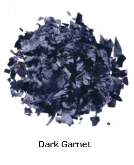

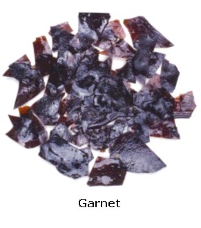

- Wax-containing Grades: Raw seedlac and alcohol solvent are charged into a dissolving tank. The solution is refluxed for an hour or so and then filtered to remove insolubles. The filtered shellac is fed to a series of evaporators where it is concentrated into a viscous melt, which is then dropped onto rollers that sheet it out for removal in flake form. Darker, wax-containing flake shellacs such as Garnet are made this way.
- Dewaxed Natural Color Grades: These shellacs are made by dissolving seedlac in either cooled alcohol of a very high proof or heated alcohol of a lower proof. The resulting solution is then passed through a filter press to remove the wax, after which the filtered shellac is then concentrated in evaporator tanks. The viscous shellac is then rendered into flakes. Dewaxed Lemon and Dewaxed Garnet shellacs are manufactured using this process.
- Dewaxed/Decolorized Grades: These shellacs are made by the same process as dewaxed grades, except that after dewaxing, the solutions are forced through activated carbon filters to remove the darker coloring constituents from the shellac. By varying the amount of carbon, contact time and quality of the seedlac, one can obtain grades of shellac ranging in color from light amber to extremely pale straw. Examples of these shellacs include Blonde, Super Blonde and Ultra Blonde.

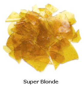

Bleached Shellac
Although most of the bright red lac dye can be removed with activated carbon, some shade of red-orange remains. For many applications, however, a nearly colorless film is preferred. Kusmi shellac, while extremely light in color, is very expensive and not available in commercial-scale quantities.
The development of shellac bleaching in the early 19th Century solved this problem with a relatively inexpensive process that could produce enormous quantities of very pale-colored shellac
The bleaching process involves dissolving seedlac, which is alkali-soluble, in an aqueous solution of sodium carbonate. The solution is then centrifuged or passed through a fine screen to remove insoluble material. The next step is bleaching the cooled solution with dilute sodium hypochlorite to the desired light color. The shellac is then precipitated from solution by the addition of dilute sulphuric acid, filtered off, washed with water, ground, and dried in vacuum driers.
The final product has a granular consistency and is dissolved in alcohol to give a milky, creamed-honey colored solution. Both clear and amber bulls eye shellac contain from 3% to 5% natural shellac wax, which gives them their somewhat milky appearance in the container but does not affect the clarity of the dry film.
