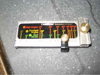

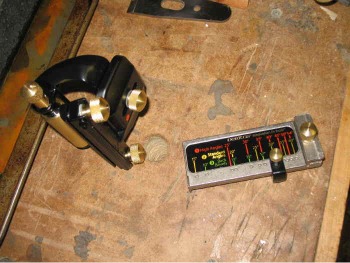

The most important innovation is the registration guide, which makes it a snap of setting the blade in the guide.

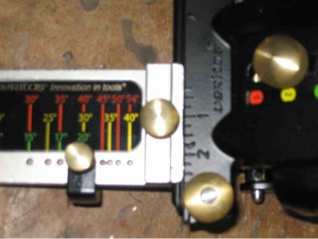

It works by choosing one of three angle scales (and adjusting the honing guide accordingly), then an angle via the adjustable stop. There are registration holes that the stop locks in, for quick and repeatable bevel angles. Also, and very important, the registration guide ensures that the blade sits square in relation to the honing guide.
There is a scale on the honing guide that allows easy centering of the blade. Here it is set for 2 3/8", the width of the No. 6 blade I was sharpening at the time.

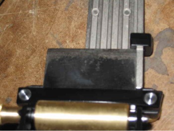

This is a view of the underside of the guide, with the blade square and angle set at 30 degrees.

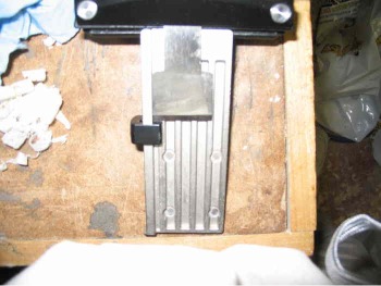

Here's another, this time with a bullnose plane blade.

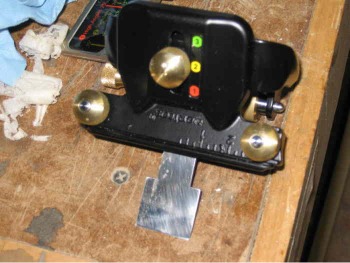

Once everything is set up (takes about a minute), clamp the blade using the two knurled nuts on the honing guide, remove the registration guide, and you're ready to go.
Here's the guide with the bullnose blade installed and the registration guide removed.
