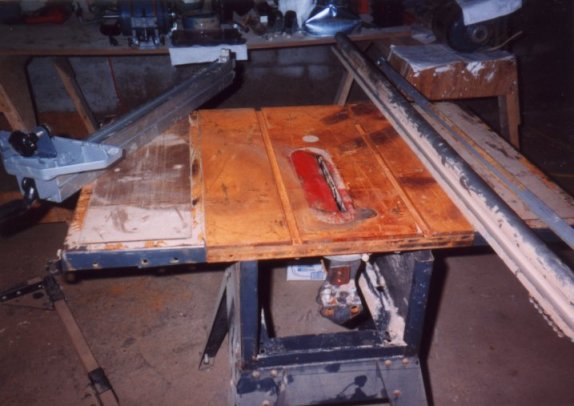

10.0  Cleaning Cast Surfaces
Below are (2) photos showing the condition of my Craftsman 10″ tablesaw after the flood. As you can see, the cast iron tabletop is pretty heavily rusted.
Cast Iron surfaces are pretty easy to clean off. You just have to be careful about how you do this. It is easy to gouge or dig into the surface. That is why I will never again use an orbital sander to remove rust from a cast iron tabletop. (DAMHIKT!)
Get a nice flat piece of wood that is roughly 3″ shorter than your Scotch Brite pad. Use this like a sanding block to back up the Scotch Brite pad. It helps to even out the pressure and make the rust removal a bit easier. Move the block back and forth over the top until you feel it is clean enough.
After you have removed the surface rust, look for pitting. If there is enough to cause concern, I would suggest lapping the tabletop. Lapping is a term associated with cylinder heads. It is a process for polishing the tops of these items against a dead flat surface (most likely a granite table top) with progressively higher grits of abrasive compounds until they are mirror smooth. You won’t have to go that far, although I did just to make the tool shine. This is where the wet dry sandpaper, spray adhesive, and WD40 come into play.
