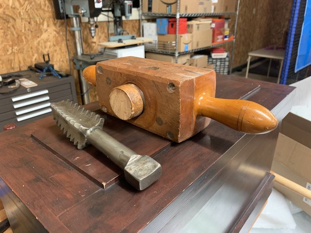

john jesseph
Here’s a tap and die I have. I’ve got a big box of sizes from small ones up to this two inch one. It’s about 2 1/4 tpi thread. The tap isn’t that complicated. It’s four rows of progressive series of teeth, offset by 1/4 the distance between teeth, if that makes sense. I’ll post another pic later, and comment more if anyone wants.
