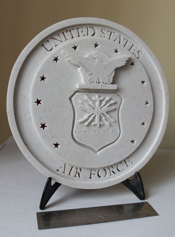

Scrollsawn Corian *PIC*
Charles Yawn
Finished this USAF emblem for my nephew. Sawn from 1/2" Corian using relief cutting on the scrollsaw. For those not familiar with that, the saw table is tilted (3 or 6 degrees for this work) and then the cut is made. Cutting clockwise or counter-clockwise determines whether the cut piece can be raised or lowered - and the degree tilt determines how much.
