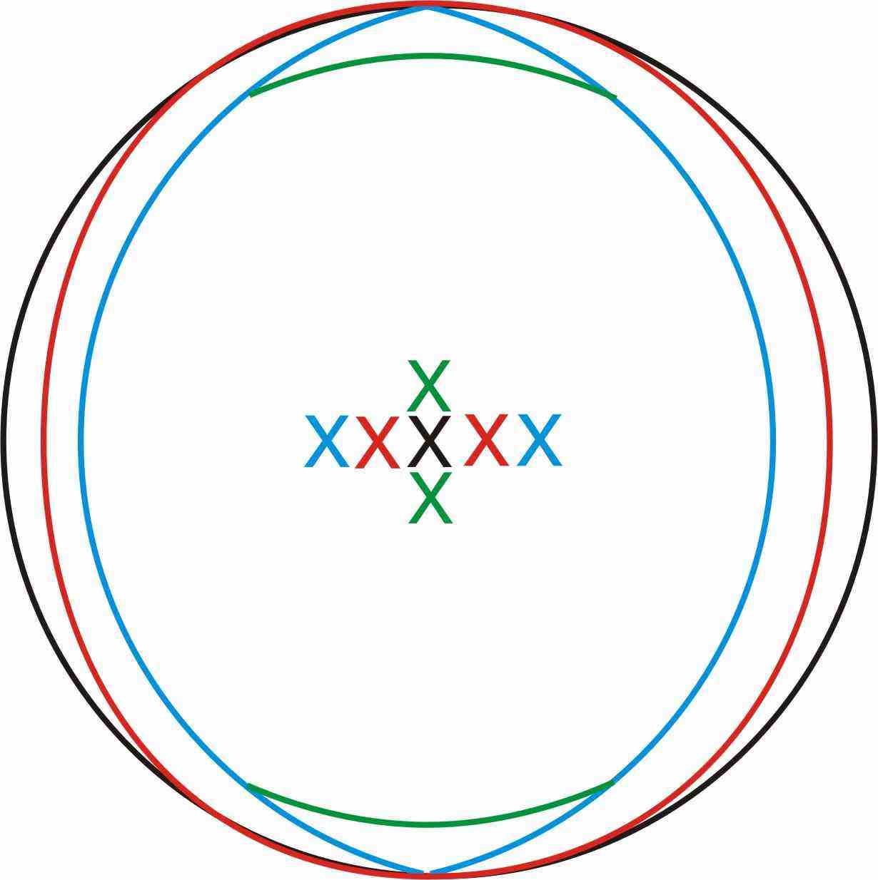

Thanks Doc.
I was fudging it a bit :) Anyway here's the corrected drawing and as you can see there is some minor sanding needed to complete the oval. In practice it's easy to move back to the true original centers and sand with the lathe running
