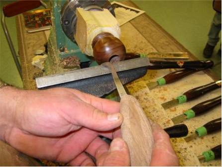

Hollowing the ball
  The next step was to drill a hole with a forstner bit. I drilled a 5/8" hole to a depth about 1/4" less than the ball diameter. This acts as the depth stop for the hollowing process. Then hollow out the ball to a thickness just less than 1/4". We used a scraper that Mike had made, it looked like the one in the picture.

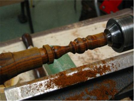

roughout for icicle
  Now we go to work on the icicle and cap finial. The stock we worked with was glued into a waste block.
Turning icicle
  Chuck the waste block in the lathe, then lay out the stock, turn it round, and use a parting tool to turn a 5/8" tenon.
Completed icicle
  Turn, sand and finish the icicle, then part it off and try it for fit in the ball.

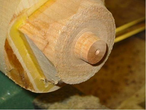

Turning cap finial
  Finally, turn the cap finial, add a 5/8" tenon, and drill a small hole for the tiny eye screw. Glue the finial and the icicle to the ball and...

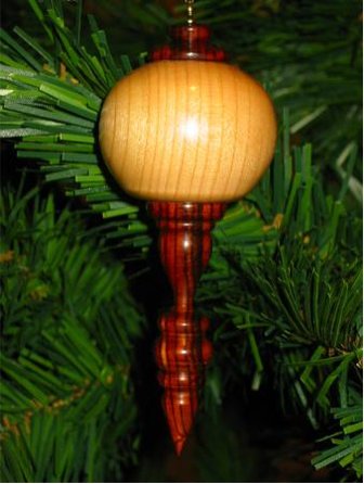

Finished ornament
You are done!
  I was very happy with my first attempt at this. I was also inspired by the others in the class. Your imagination is the limit here.
This ornament is a cherry ball with a cocobolo icicle, it's about 6 inches tall.
