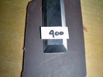

120 grit
Progressing through 80, 120, 400, 1000, 3200, and 6000 grit. About a minute or two to get through each step including flipping or changing the platen.
400 grit
There are some really fine scratch marks remaining, likely due to the jump from 120 to 400, but they certainly didn’t affect performance. I also failed to keep the chisel back flat on the rest’s abrasive, so I was left with a small burr. Once I noticed it, I adjusted my technique and the burr was removed automatically.
